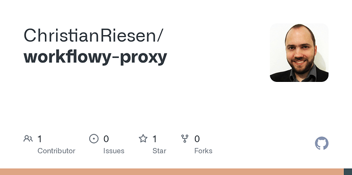

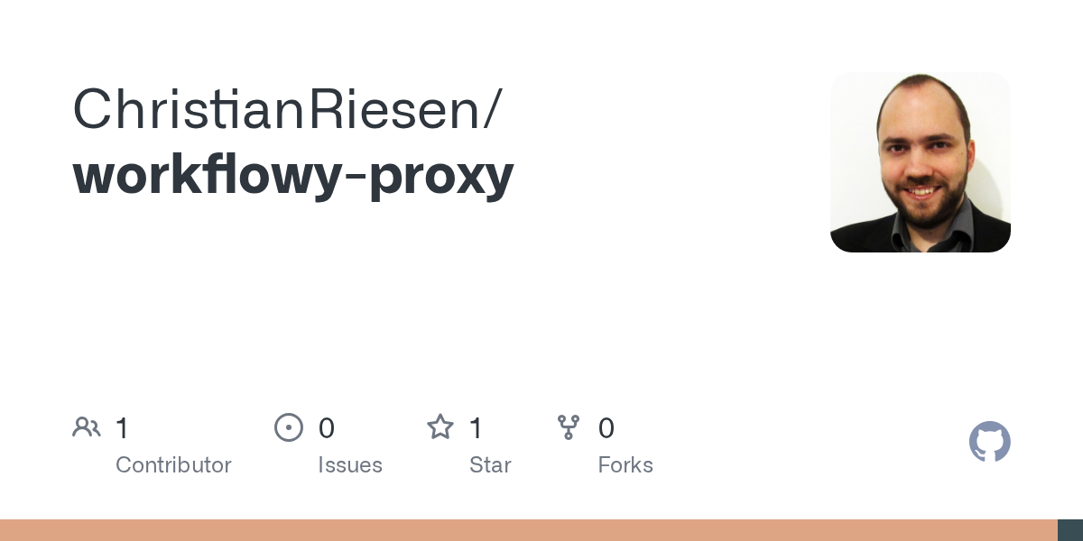

Glad I could be of help. I was digging into this so I could properly work with Workflowy and my agents that I have reading and writing in Workflowy. I went that far to make my own proxy since my needs are heavy read intensive. Maybe could be useful to you as well, and in the readme I also have the ratelimit explenation again.
