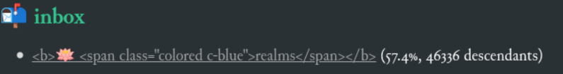

When I run workflowy report count -f markdown, the output includes html formatting e.g. <span> and <b>. Example:
- [<b>🪷 <span class="colored c-blue">realms</span></b>](https://workflowy.com/#/redacted-wf-guid) (57.4%, 46336 descendants)
When I paste this into WF (either manually copied from the terminal with Ctrl-Shift-C or piping to wl-copy) I get this:

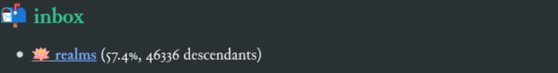

When I paste into StackEdit then copy-paste the result into WF, I get this

Oh interesting, I see the issue. WF is exporting formatting as HTML, and not as Markdown. It seems StackEdit is either stripping the HTML tags (or converting them back to Markdown), which WF them imports properly. I could probably do the same in the report generation, perhaps controlled with a flag.
